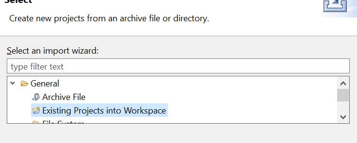

  2. Select 'Import' from the Eclipse 'File' menu, then 'Existing Projects Into Workspace' in the resultant window before clicking the Next button.

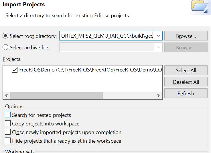

3. In the next Window, select /FreeRTOS/Demo/CORTEX_MPS2_QEMU_IAR_GCC/build/gcc as the root directory, check the FreeRTOSDemo project, and crucially ensure the "Copy projects into workspace" checkbox is unchecked, before clicking the Finish button to bring the project into Eclipse.

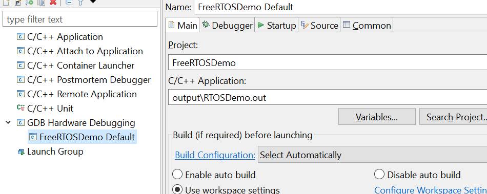

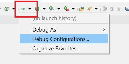

Omit the "-s -S" if you just want to run the FreeRTOS application in QEMU without attaching the debugger. 8. Click the little arrow next to the green bug speed button, then select "Debug Configurations..." from the resultant menu.
9. In the debug configurations window, select "FreeRTOSDemo Default" from under "GDB Hardware Debugging", then click the Debug button. The Eclipse debugger should create a GDB connection to QEMU, start a debug session, and break on entry to the main() function.
