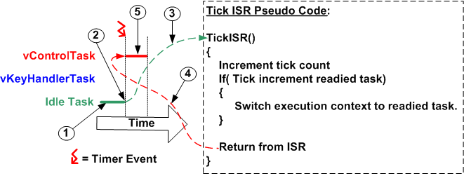

Each time the tick count is incremented the real time kernel must check to see if it is now time to unblock or wake a task. It is possible that a task woken or unblocked during the tick ISR will have a priority higher than that of the interrupted task. If this is the case the tick ISR should return to the newly woken/unblocked task - effectively interrupting one task but returning to another. This is depicted below:
Referring to the numbers in the diagram above:
  • At (1) the RTOS idle task is executing.
  • At (2) the RTOS tick occurs, and control transfers to the tick ISR (3).
  • The RTOS tick ISR makes vControlTask ready to run, and as vControlTask has a higher priority than the RTOS idle task, switches the context to that of vControlTask.
  • As the execution context is now that of vControlTask, exiting the ISR (4) returns control to vControlTask, which starts executing (5).
A context switch occurring in this way is said to be Preemptive, as the interrupted task is preempted without suspending itself voluntarily.
